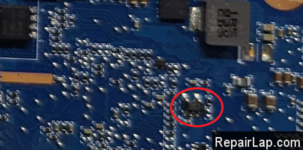

i need you to check from the picture above if the 3.3V And 5V is been available .I tried all the bios without result, I have a question, what is the second file that is next to the bios named 16mb for? the one that weighs 1 MB
410 mv on diode scale, there does not appear to be a short circuiti need you to check from the picture above if the 3.3V And 5V is been available .
a short circuit does't appear by voltage we check a short by ohms410 mv on diode scale, there does not appear to be a short circuit
6k ohmsa short circuit does't appear by voltage we check a short by ohms
can you show me where did you check the 3.3V and 5V , send a picture .6k ohms
Try to change this circuit first .realizar la medición en este IC
Could you help me with the datasheet?Try to change this circuit first .
i did a search but it seem not available .the only thing you have to do is to look for some similar motherboard .Could you help me with the datasheet?
I told you to change the ic .I Have 0V in
