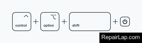

Here’s how to reset the SMC on any Mac notebook model with the Apple T2 Security Chip:
  1. Shut down your Mac.
  2. Press and hold the power button for 10 seconds, then release the button.
  3. Wait a few seconds and restart your Mac.
  4. If that doesn’t help, shut down your Mac again.
  5. Press the right Shift, the left Option key, and the left Control key and hold for 7 seconds. Then, press and hold the power button.
  1. Keep holding down all four keys for another 7 seconds. If your Mac has turned on, it will turn off as you hold down these keys.
  2. Release the keys and wait a few seconds. Then, restart your Macbook laptop.

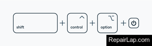

Here’s how to reset the SMC on notebooks with non-removable batteries:
  2. Press and hold Shift, Control, and Option on the left side of the keyboard. At the same time, press the power button.
  1. Hold for 10 seconds.
  2. Release the keys and then turn on your Mac.
