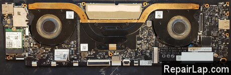

this file does't have a me region , can you upload a picture for your motherboard ,need to know the part number and the right model of your laptop .
